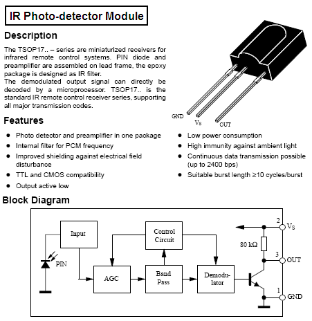

I don't know what a TSOP module is.
There isn't an electronics store in all of India?
Posted - Apr 11 2010 :  1:01:31 PM  Show Profile  Reply with Quote
A TSOPxxx is an IR receiver IC that is made by Vishay/Telefunken.
It has a black coated photo-diode, amplifier, tuned filter, AGC, Demodulator and output transistor.
Download Attachment: TSOP IR receiver.PNG
29.03 KB
