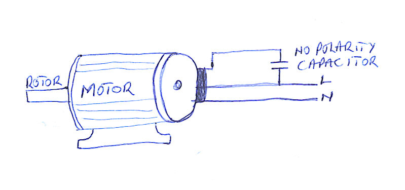

                      |  Good day to you, my motor has three wires, one wire connects to one terminal of the capacity, another connects to  both the other capacitor terminal and the live terminal while a third one connects to the neutral line. Where of these three terminals do I connect the 9V battery to excite the windings as you said. Please see the motor picture i drew. For more information. |

                       Posted - Mar 12 2010 :  11:19:43 AM
