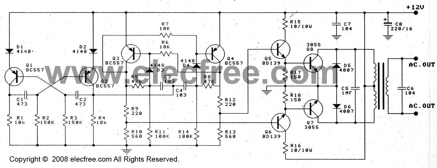

What is the best transf for 12v to 220v 3A
republicn@maktoob.com
Download Attachment: circuit-inverter-100w-12v-to-220v-by-transistor.jpg

If you want to make 220V at 3A from 12V, you need to draw 60A (actually more due to inefficiency) at 12V. That circuit won't do it. Full out, those 2N3055s are limited to 15A each on a massive heatsink.
