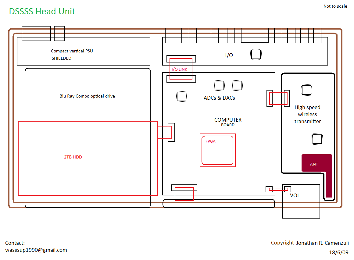

Posted - Jun 17 2009 : 10:38:46 AM
The mid year break is comming for me. The work load is easing.
My latest diagram:
Download Attachment: DSS head unit layout.png 43.43 KB
