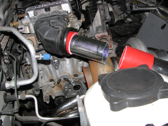

is anyone out there making the strawberry(intake)........my opening is 2.5"
Download Attachment: IMG_0277.JPG

As far a I know, no one actually produces them. My original "Strawberry" concept was not very good as well since it provided a very turbulent transition and basically dumped air right where the secondary throttle plates would go.
If you are going to make a Strawberry, make sure to provide a smooth transition between the smaller tube size and larger throttle body. You can use a commercial conical reducer fitting, or roll your own with sheet metal and a roller.
