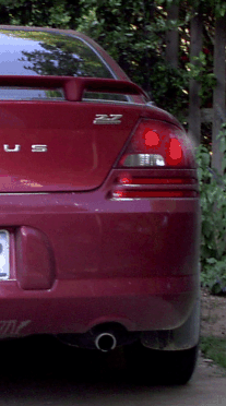

on my stratus there are two reflectors under the rear light, i want to place LED's in these. i would like it to light and stay lit until the last light is lit, then repeat,
this link has an image of what i would like this,
http://deneau.info/stratus/blinky3.gif

If you know how to program in C or assemmbler you can program a PIC chip to do that.

can i hook up 8 led's between ports PB0-PB7, 8 between PD0-PD7, 8 between PA0-PA7, and 8between PC0-PC7. and then program each led to have it's own turn on/off time, to get them to flash like in the picture?
