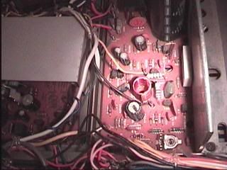

I have an old Radoshack STA-720 reciver that has a bad power amp on the left channel. The sound from it makes me think that the power transistor is unbiased.
What should I look for when I try and repair this? Is it more likely that the transistors are damaged or possibly the capacitors are bad?
http://i3.photobucket.com/albums/y97/cirvin/amp.jpg
^pic of the amp board, if it helps...

hi Cirvin if the other channel is functioning properly make a voltage reading of the transistor leads and then compare it with the bad channel.I usually check the output going to the speaker and make sue that there is no DC voltage.that is if it was a briidge transformerless design.Since its an old unit replacing all the capacitors is also a time saving solution.
