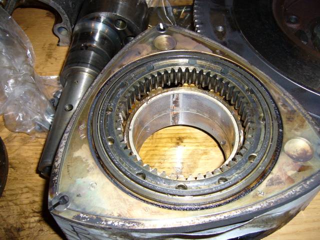

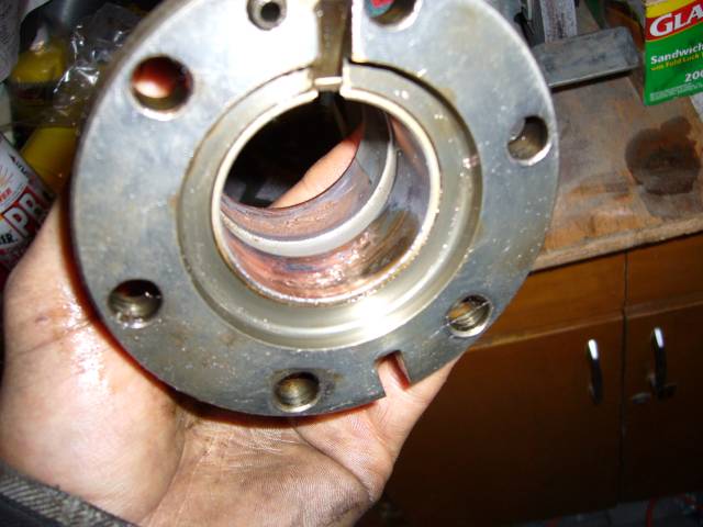

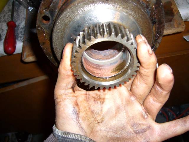

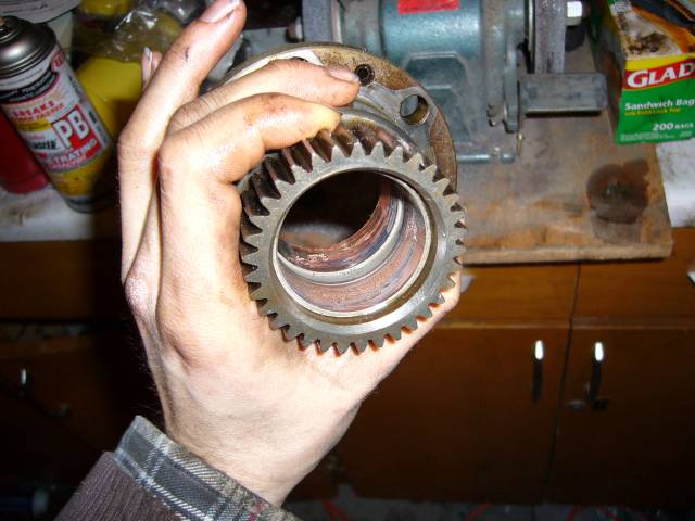

On Saturday a friend and I disassembled the 13B turbo rotary engine from his '88 RX-7. It was not actually blown up but several....mishaps....had caused a crack in the rear at the point the oil pressure sender screws in. This meant an enormous oil leak which he and I, as well as a professional welder, had tried to weld up several times. Unfortunately due to the difficulty in accessing the location as well as the challenge of welding on oil soaked cast iron, it didn't work. The only choice was to rebuild the engine.
Disassembly went fine until I took a look at the bearings. I was shocked to find out that they looked like the attached image. Now to everyone who is not familiar with the rotary, those bearings are in the stationary gears that support the entire rotating assembly. The bearings should be perfectly smooth as one would normally expect from a bearing. These however have clearly been eaten away. It looks like due to all the welding and messing about the oil passages, a significant amount of grit got into the engine and the oil passage was restricted at some point (it was continually being welded, ground down, welded again, etc.). This caused oil starvation and ate away at the bearings. The eccentric shaft (which passes through those bearings) is also deeply scored and must be replaced.

It could have been much worse if the car was being driven in it's current condition. The engine would have soon seized solid basically destroying the rotating assembly. The last engine I dealt with that had oiling problems required three of us with pry bars and a torch to disassemble, and replacement of every part of the rotating assembly.
