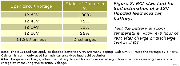

Audioguru,
Using a 12V Flooded Lead Acid Car Battery or any 12V battery,
which o/p voltage of the battery to be consider in designing a Ckt. ?
...I mean the battery reaches 13.8V- 13.5V when charged but its nominal voltage is 12.65V (according to the table @ Battery university) when the load is not connected?
So, does it mean that in my Ckt. here I must consider the supply voltage as 12V not 13.5V ?

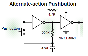

audioguru Posted - Aug 31 2008 : 12:53:37 PM
The pushbutton on my latching circuit turns on the inverter if the battery is charged. It does not turn off the inverter.
If the latch is Reset then pushing the button won't do anything.
An "alternate action" circuit has an output that goes high when its button is pushed then it goes low if the button is pushed again. Its output alternates each time the button is pushed.
Inverting gates can be used instead of inverters.
Download Attachment: Alternate-action.gif
6.69 KB
