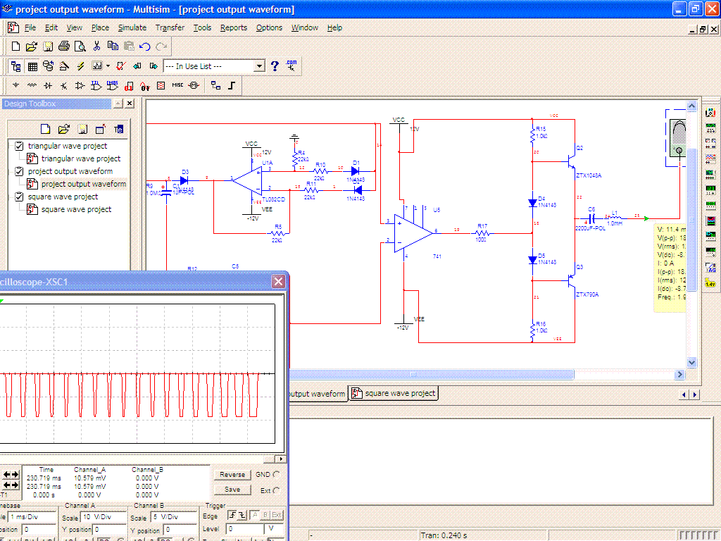

Posted - Mar 08 2011 : 6:50:41 PM Hi all, I need help with my design. I am designing a pure sine wave inverter to produce 60 volts ac from 12 volts dc. I used a wien-bridge for the oscillator section and calculated the capacitance and resistor values to give me a pure sine wave output @ 51 hz. My problem now is how to proceed from here. I tried connecting a transformer directly to the output of the oscillator circuit and connected a resistor as load for simulation purposes. The amplitude and voltages have gone down. Also when i was running the oscillator simulation on it's own, it takes some time before it gradually builds up the amplitude until it gets to a pure sine wave, why is this? Thanks.

Posted - Apr 19 2011 : 8:48:05 PM 1) Throw away the old 741 opamp and replace it with a proper comparator iC like an LM393 dual comparator. 2) Increase the triangle waveform to 30kHz using a faster opamp like a TL081 or MC34071. 3) The output of the comparator can drive complementary Mosfets that feed the LC filter. |

| audioguru |
Posted - Apr 19 2011 : 08:33:04 AM I saw your very fuzzy DOC file on another website. Did you know that a lousy old 741 opamp is 43 years old and has trouble above only 9kHz? Most opamps made in the past 30 years go perfectly to 100kHz.
In your schematic I cannot see at what DC voltage the inputs of the 741 opamp are biased.
It looks like your PWM carrier is only 2kHz (so it will be very noisy) instead of 20kHz to 200kHz.
Your circuit with Mosfets and an extremly slow LM324 opamp will not work. |
