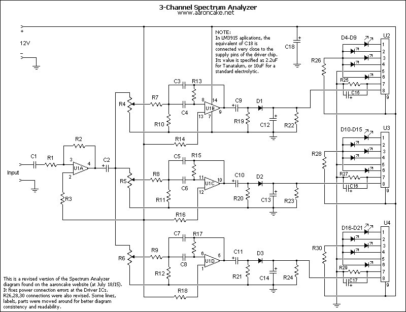

Hello,
Attached is a revised wiring diagram with corrected power connections.
About AN6884...
- datasheet can be found here:
http://www.bsselektronika.hu/pdf/opto/an6884.pdf
- NTE make a replacement ic for the 6884 (nteinc.com)
- suppliers can be found on eBay (these may be cheap knockoffs,
quality is unknown).
@ aaroncake:
Feel free to use the revised diagram
@ JP04294:
1) using the circuit as designed, I think you should be able
to put 3 LEDs in series on each driver output line, assuming
a 12V supply.
I used this idea with an LM3915 circuit, and had 5 LEDs in
series. The circuit was powered by a 12V (nominal) wall wart,
which actually put out about 16V.
2) If you google "voltage spikes in a car" you'll find lots
of info.
3) A microphone signal isn't powerful enough to drive this
circuit (unless it's amplified before feeding to the Analyzer).
As noted in the circuit info, use the "Line Out" of your audio
system. So yes, an audio jack is fine.
Note that the output levels of some devices (mp3 players, etc)
may also not be strong enough. In this case, you could try
boosting U1a gain, and/or adding another stage of amplification.
4) you asked about removing the Driver ICs... technically, yes
that's doable. But you should use something else as a LED driver
(even a simple transistor, to buffer the filter circuit). But
this leads into a whole other project. I don't understand your
idea of using a potentiometer.
5) you say: "wish for the whole array (respectively with each
filter) to light up consistently"
What does this mean?
Edit (July 20/15):
The diagram has been further revised. No errors, just making
the modularity of the sections more obvious.
John
Download Attachment: 3ch spectrum-mod.jpg
95.52 KB

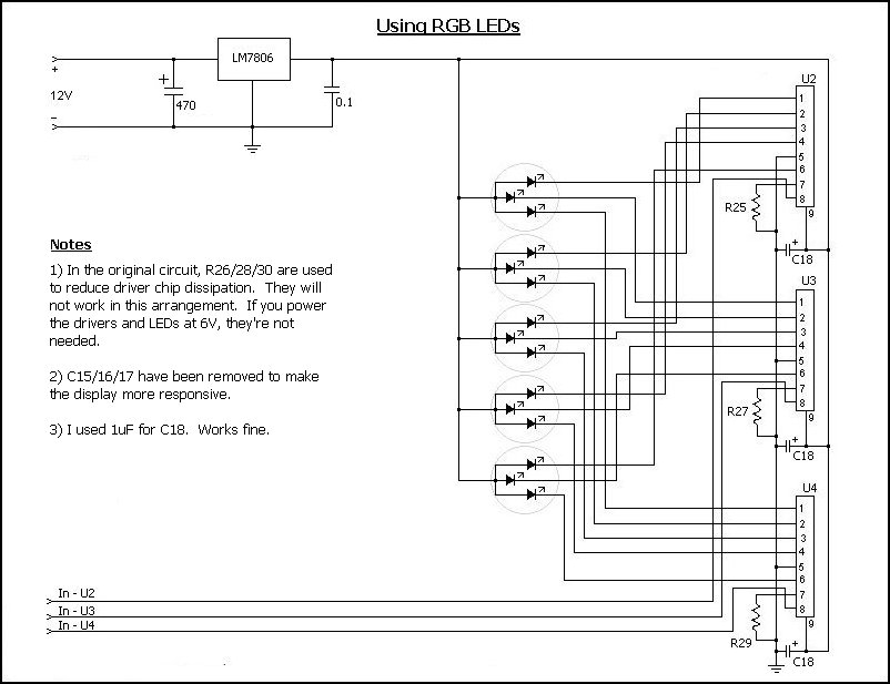

3) if you want "spectacular", then consider switching to RGB LEDs. See the attached circuit diagram.
John
Download Attachment: AN6884 w- RGB LED.jpg
74.72 KB
